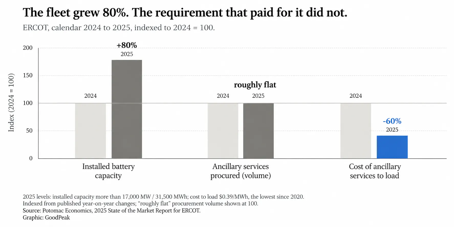

The installed battery fleet grew by almost 80%, to more than 17,000 megawatts and 31,500 megawatt-hours. The volume of ancillary services ERCOT procured stayed roughly flat. And the cost of those services to consumers fell 60%, to $0.39 per megawatt-hour, the lowest since 2020.
A market where battery supply nearly doubles, the quantity bought does not move and price collapses is not behaving strangely. It is behaving exactly as it should. What makes it worth explaining is that the same grid is forecast to need considerably more flexible capacity over the decade that follows.
The revenue consequence was immediate. Revenue per unit of battery capacity fell 37% in a year, and ancillary services fell from 97% of an average ERCOT battery’s revenue to 28%. On Modo Energy’s tracking as of August 2026, the average battery had earned roughly $30 per kilowatt over the trailing twelve months, about an eighth of the same measure two years earlier. Fleet averages conceal wide variation by node, duration and how actively an asset is optimized, but the direction is clear.

ERCOT determines how much of each ancillary service to procure through statistical analysis of historical variability, principally net load forecast error, calculated by month and hour and reviewed annually. The requirement is sized by uncertainty, not by demand. A grid twice as large does not need twice the operating reserves. It needs enough to cover how wrong the forecast might be.
The 2024-25 data shows the mechanism at work. The total requirement barely changed, even as its composition shifted for reasons unrelated to storage growth. Contingency reserves fell more than 19% after ERCOT changed a risk adjustment, while regulation and non-spinning reserves increased as forecast errors grew. None of those changes depends on the size of the storage fleet. ERCOT already procures more operating reserves than any other US grid operator, yet the total requirement across all five products remains in the single-digit gigawatts. The storage fleet alone now exceeds 17 gigawatts.
The Independent Market Monitor goes further than the arithmetic requires. Potomac Economics writes that ERCOT’s procurement practices “raise the AS requirements to more than double the ancillary service quantities needed to achieve a reasonable standard of reliability.” On that reading the requirement is not merely fixed against a growing grid. It is larger than reliability warrants, which makes the direction of any future adjustment more likely down than up.
